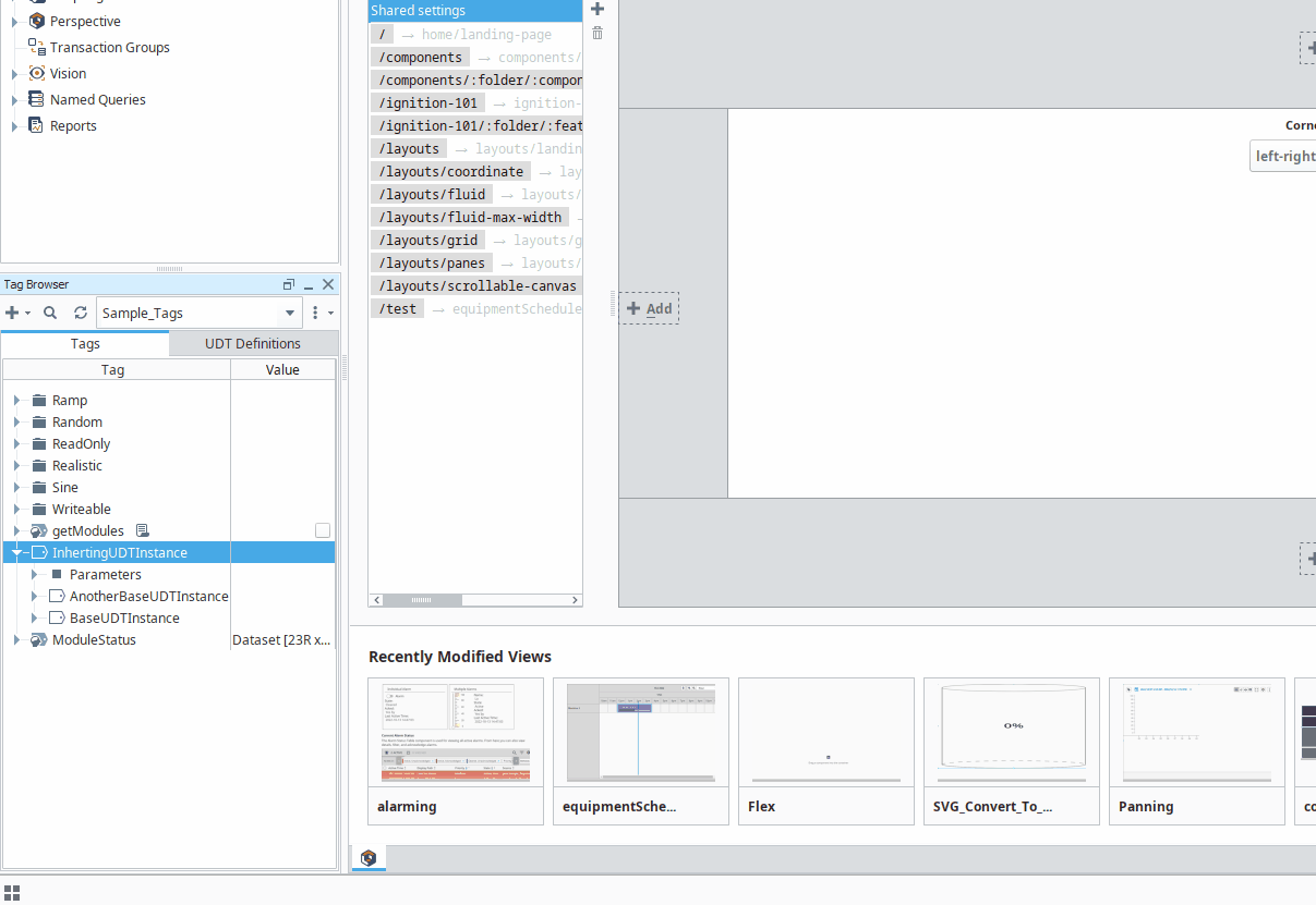

The UDT Hierarchy Tool is the newest overview-focused addition to the Ignition family tree. Like its recent ancestors, the Tag Report Tool and the Configuration Explorer, the UDT Hierarchy Tool provides a fast way to see how the pieces of an Ignition system fit together.
To use this tool, simply right-click on a UDT and choose “View UDT Hierarchy.” This will open a window listing the Type Hierarchy and Tag Members. The UDT Hierarchy Tool displays the entire lineage, listing both UDTs inheriting the chosen UDT as well as what types the chosen UDT is inheriting from. Overridden properties associated with each tag member can also be viewed by clicking on the individual tag.
UDT Hierarchy Tool
In addition to providing at-a-glance knowledge, this tool will make troubleshooting highly complex UDT structures much easier. Now, if something goes wrong, the UDT inheritance can be immediately parsed instead of playing guess-and-check with each modification in a UDT until the cause can be identified.

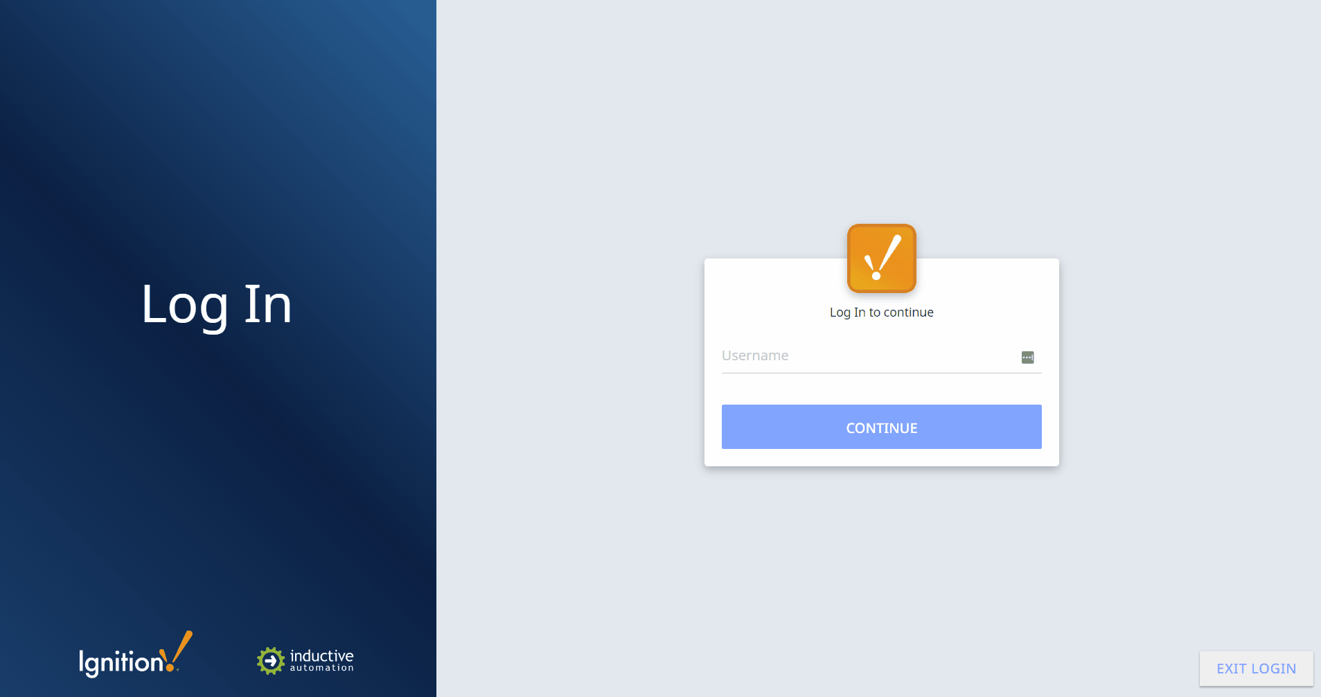

Be the Change You Want to See in Your Password
There’s a reason we always ask for feedback at the bottom of each update blog: you’ve got some great ideas! 8.1.23 features a highly requested update to internal identity providers, which allows users to reset an expired password through the internal IdP directly from the login screen. No more going back to the gateway!
Update Password IdP
“Of course I updated my password … just give me one sec …”

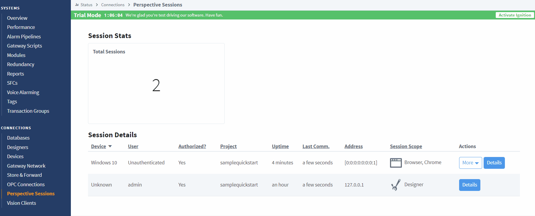

I’ll Be Back (to Work on This Later)
More practical than a time-traveling cyborg, Ignition 8.1.23 adds the ability to terminate Perspective Sessions from the Perspective Session status page. This feature, which used to only be available in Vision and the designer, provides more control in Perspective directly from the gateway.
The Terminator

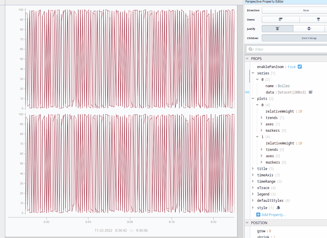

Weight vs. Mass
Whether you’re a painter, filmmaker, or developer, when you’re trying to communicate information visually, size matters. For the compositionally minded, 8.1.23 adds the new "relative weight" property. Located under plot configuration, relativeWeight modifies the amount of relative space that each plot occupies in a Time Series Chart to better emphasize one part of the chart over the other.
Relative Weight

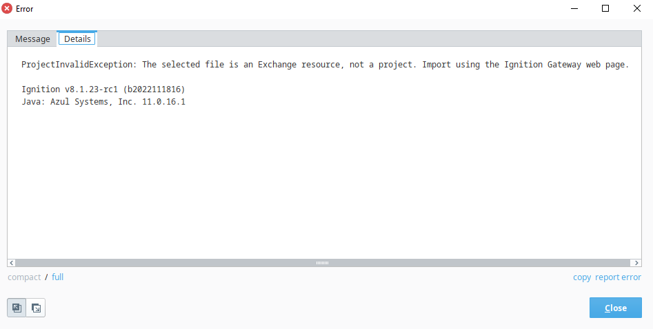

Ignition Exchange
  • The below error message now appears when Ignition Exchange resources are improperly imported as project files in the designer and gateway. A detailed walkthrough for importing Exchange resources can be found here.
Exchange Error
