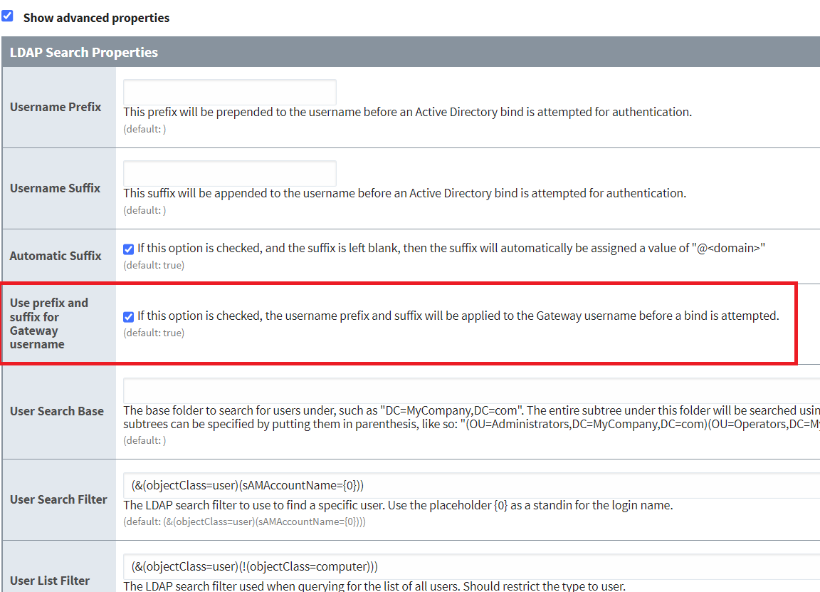

Username Prefix & Suffix
A customer-requested feature adds a new checkbox option in the LDAP Search Properties for toggling username prefix and suffix to all three Active Directory user source profiles. If marked as true, this setting applies prefix and suffix to the gateway username before a bind is attempted. Naturally, this option defaults to true on upgrade to match the behavior before the upgrade. It’s also worth mentioning that 8.1.24 removes the strict validation for gateway username setting so that =, ,, and other characters are now allowed.
Prefix and Suffix

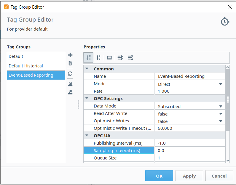

Ignition puts a premium on configurability, not just within the platform itself, but also with how it interacts with outside hardware and protocols. To better adapt to systems subscribing to BACnet or DNP3-supported devices, Ignition 8.1.24 has a new Tag Group OPC UA extension property that allows the Sampling Interval to be requested independently of the Tag Group Rate.
If the Sample Interval is set to 0, instead of Tag Group polling, event-based or report-by-exception changes will come directly from the device. For certain devices or system architectures, this method reduces unnecessary sampling to save additional overhead.
OPC UA Event-Based Changes

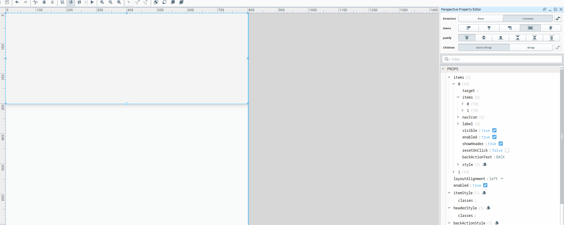

Menu Tree
The Menu Tree component’s "backActionText" root now acts as the default back button for all levels of menu items. Individual sub menus can then override this text with their own "backActionText" configuration property. As exemplified in the GIF below, this update provides more clarity when backtracking through heavily nested menus.
backActionText

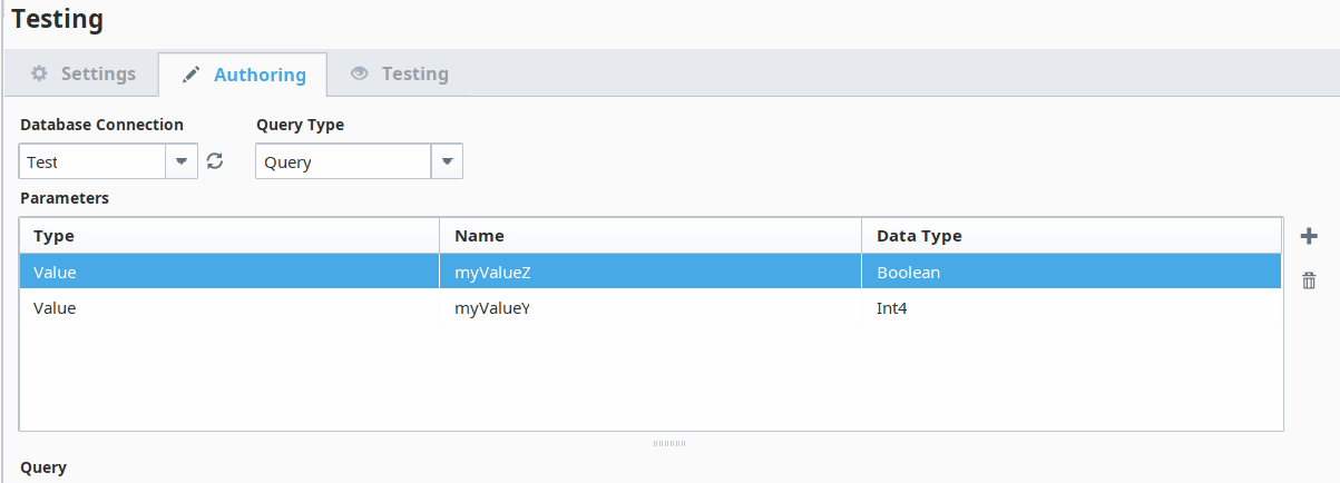

8.1.24 now automatically commits any changes made in the Named Query Authoring tab when you switch to another tab. This change provides a quicker, more user-friendly experience when testing out queries. All you need to do is edit your parameter and switch tabs. No more forgetting to press Enter, and no more double-checking.
Auto Commit

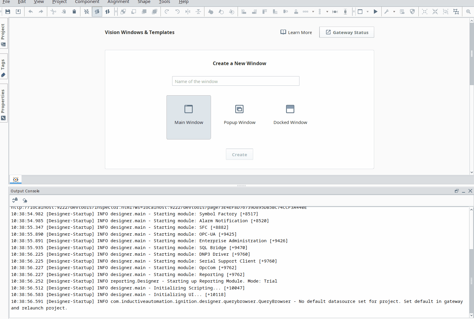

A double portion of delicious side dishes comes from the Designer edit menu, which gets some expanded functionality and can now be used against Output Console messages as well as Vision Property Editor fields. Previously, tediously, frustratingly, these tasks were not possible. Now, simply highlight the desired value or input, click Edit from the top menu, select Copy, and paste into a new window.
Copy to Output Console
Copy to Vision Property Editor
