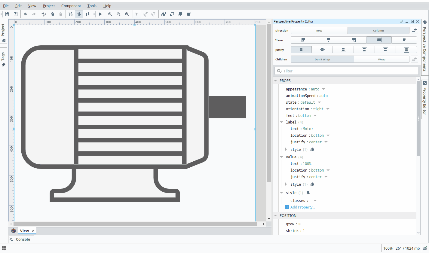

Symbol States
8.1.26 adds a new Symbols section to the Perspective Project Properties menu that lets you create new symbol states and override existing states with unique colors and/or animations. This feature opens up a variety of customization options; for example, if you need to visually differentiate multiple fault types or simply change a symbol’s color to indicate whether it is on or off.
Symbol States

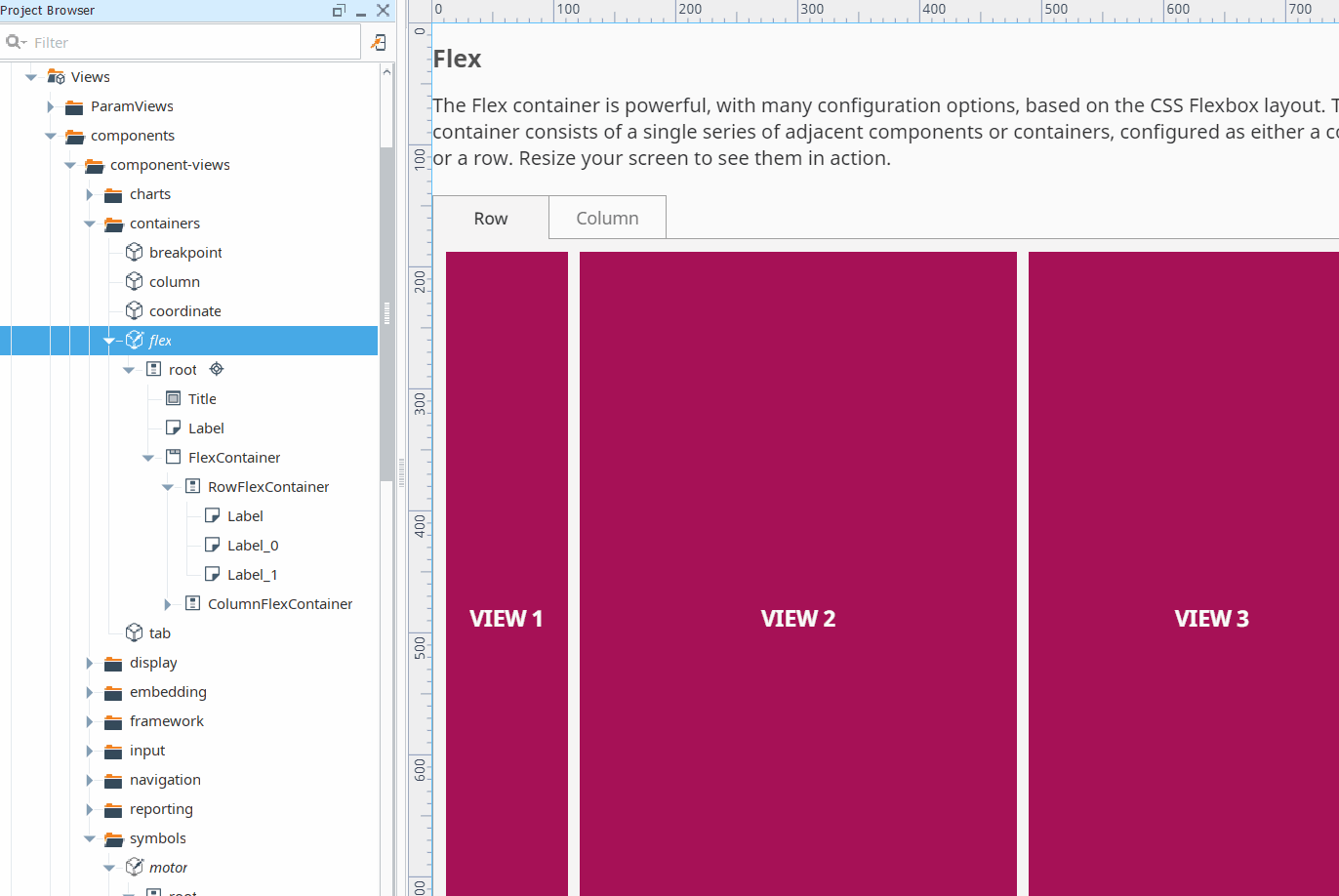

Deep Select
In 8.1.26, pressing Alt + Shift + Click in the designer will now deep-select an embedded component or container. In previous versions, digging down to the base layer was somewhere between cumbersome and frustrating. This new hot key ensures that when you need to make a change, you can immediately get to the core of the matter.
Deep Select

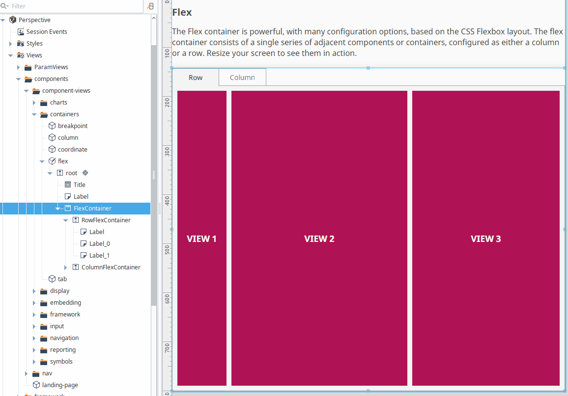

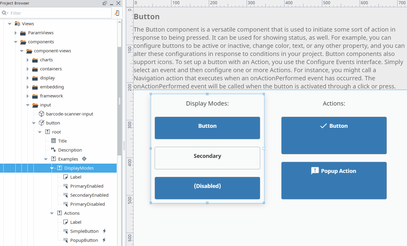

Inline Text Edit
Similarly, you can now edit inline text for the Label, Toggle Switch, Checkbox, Button, and Radio Group Component labels with the same Alt + Shift + Click deep select. Before, even when the Button Component was deep-selected, for example, it was only possible to edit the text by clicking on the text property off to the side. This improvement makes changing text simple, elegant, and much, much faster. Trust me, I understand the need to fix your typos before anyone notices.
Inline Text Edit
Cycle Selection
Pressing Shift + Click will now cycle through the embedded layers of a selected component or container. The ability to embed components, containers, and views is an important facet of Ignition, allowing you to layer functionality into your project as you build it. While the above-mentioned deep select is preferable for diving straight to the base, this hot key is perfect for easily parsing through those middle layers.
Cycle Selection

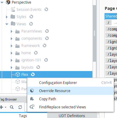

Badge and Menu Icons
8.1.26 includes new badge icons that better indicate when resources are inherited or overridden. These icons offer an immediate way to differentiate resources at a glance while moving through the Project Browser. Additionally, right-clicking on an inherited resource now displays a context menu with similarly placed menu icons to visually reinforce available actions.

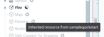

Inheritance Hierarchy Tooltip
Badge icons can also provide some quick specificity. Simply hover the mouse over the icon to activate a tooltip that displays the inheritance hierarchy. This is a quick way to give context to the parent/child dynamic of a chosen resource.
Inherited Hierarchy Tooltip

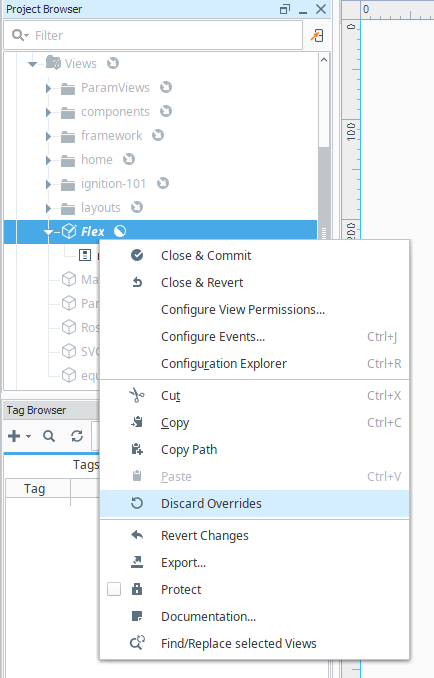

Discard Overrides
In the context menu for a child project’s overridden resources, the “Delete” action now has the more accurate title of "Discard Overrides." The function of this action is identical, but in prior Ignition versions, some users were understandably concerned that choosing “Delete” would delete an entire resource from the child project, which was not the case.
Discard Overrides

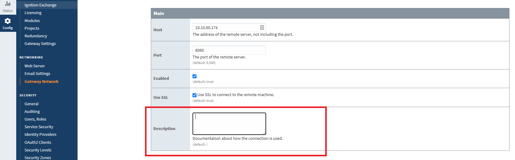

Gateway Network
  • Outgoing gateway network connections now have a user-populated description field to document additional context about the connection’s use.
Gateway Network
