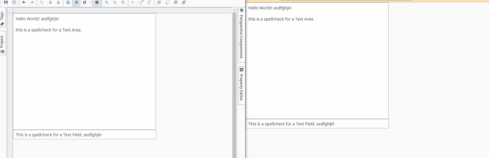

Perspective
  • Added a new spellcheck property for Perspective's Text Area and Text Field components. Now, Microsoft Word-style wavy red lines will appear beneath incorrectly spelled words only when you set spellcheck to “true.”
Spellcheck

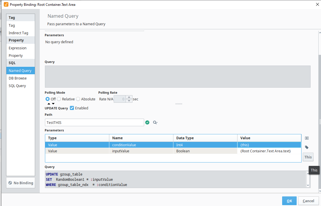

Store & Forward
  • Added a button labeled This for convenient insertion of the {this} variable into Named Query binding parameters, a feature already available in SQL Queries.
This

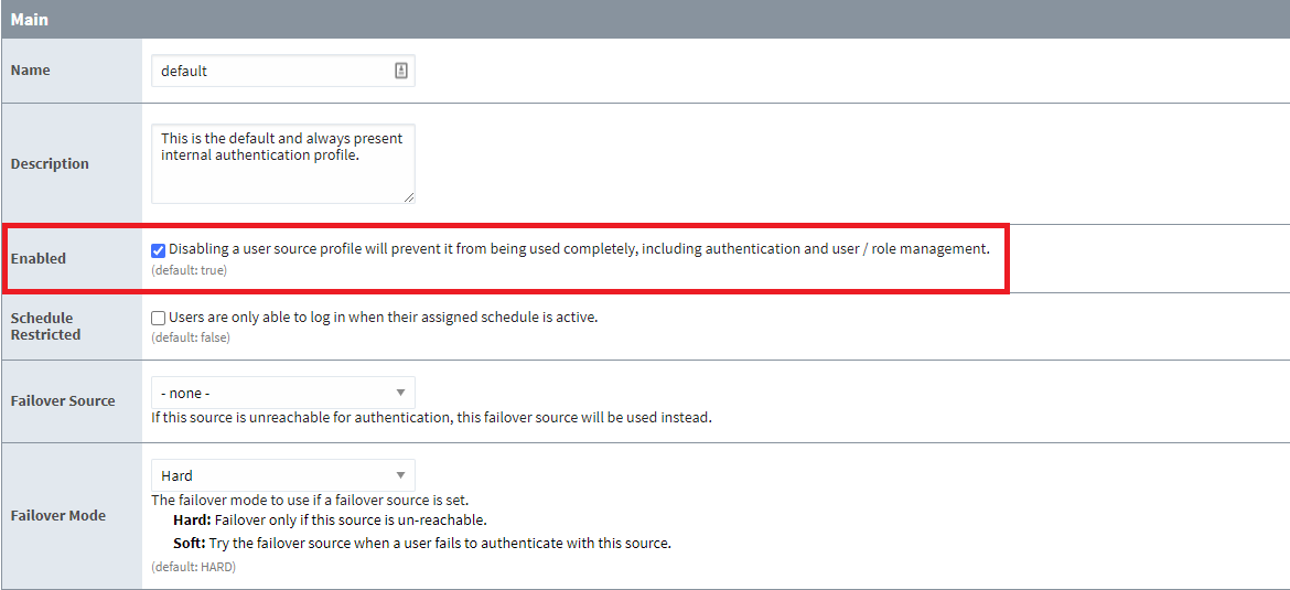

User Sources
  • Added a checkbox to disable a User Source profile in the User Source profile config page.
Enabled Checkbox
